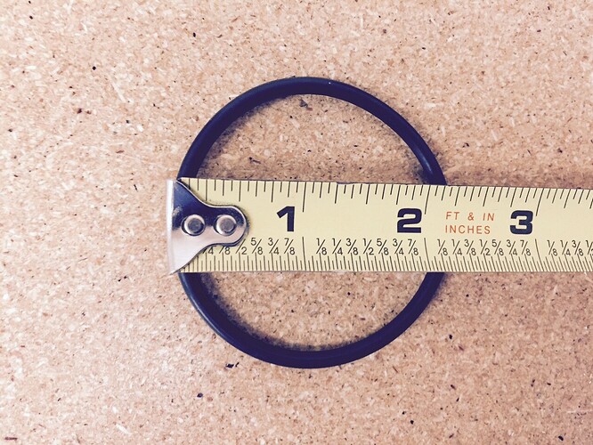

Below is the photo with the dimension of the o-ring in question. Could you let us know which salt sytem you have and where the o-ring is located?

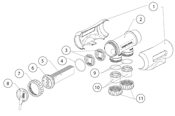

I have a Compupool CPSC48 and the o-ring goes between the Clear Electrode Housing Body (2) and the CPSC Series Electrode Housing Pipe Adapters (10). The o-ring (9) part number is JD363PIPO

The JD363PIPO part # 2807-200 O-ring would be the correct O-ring, many times the o-ring stretches or distorts over time making it larger then the original o-ring size.

The O.D is 2-1/4" the I.D is 1-15/16" and the Cross-section is 1/8"

Is it possible you need o-ring #4 in the schematic, can you send us a photo of your system and pointing out the location of the o-ring within the photo?
