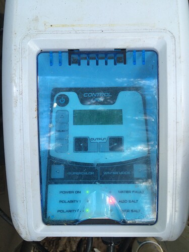

The LCD screen on my CPSC16 is out. The LED lights do come on. No chorline being generated. I think the LCD needs to be replaced but I’m not sure of the age of the model…see 2 photos below for controller and serial number. Is the LCD display (part number # JDPCBLCD) you have available to proper part for this unit?
Hello,  Yes the Display PCB, JDPCBLCD, is the replacement Display Board for all units in the older CPSC SCG series, including CPSC16, CPSC24, CPSC36, and CPSC48. And we the board in stock.
