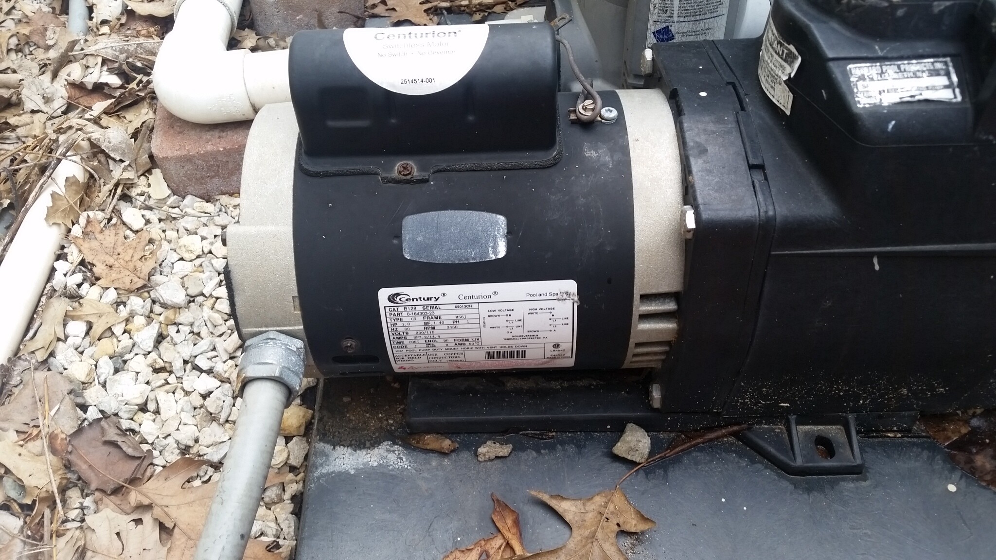

I can’t read the label on the Hayward Pump - it is too deterioated as you can see here.
I can tell you its more than 10 years old, and the pool 12-16,000 gallons (14 x 30 x 4 deep)
Is there another way to determine the pump model so I can get the correct gasket?
Hi Gaylen, can you supply two more photos a wider shot showing the complete pump with lid and basket and a second which is a very close up shot of the motor label.
