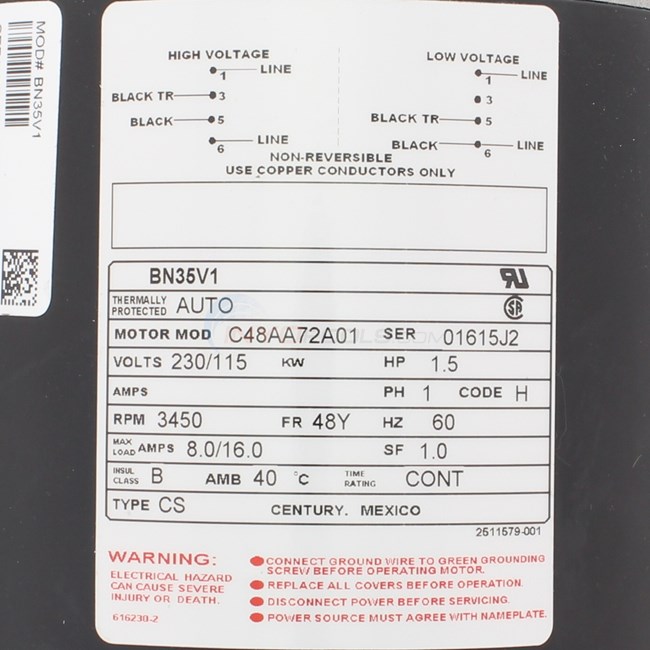

Bn35v1 wire to 230 help
Wiring my pup bn35v1 to 230 volt can someone help me out?
Hello Moncada89 - The BN35V1 should have come from the factory set on 230v. In that case you would just connect one hot line to terminal 1 and the other hot line to terminal 6. The ground line would go to the green screw. Below is a wiring diagram. Your wiring should look like the one under “High Voltage”.
