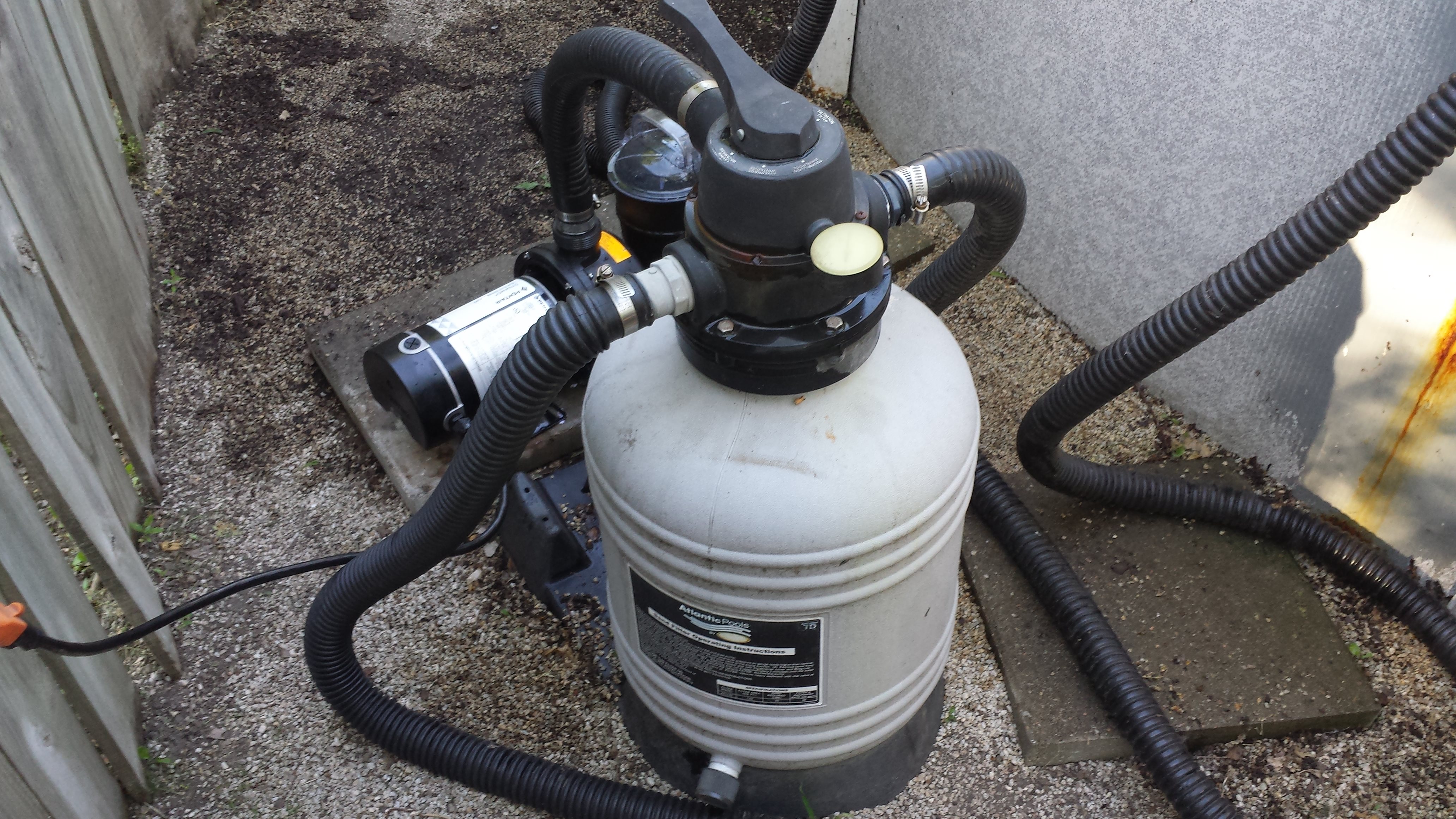

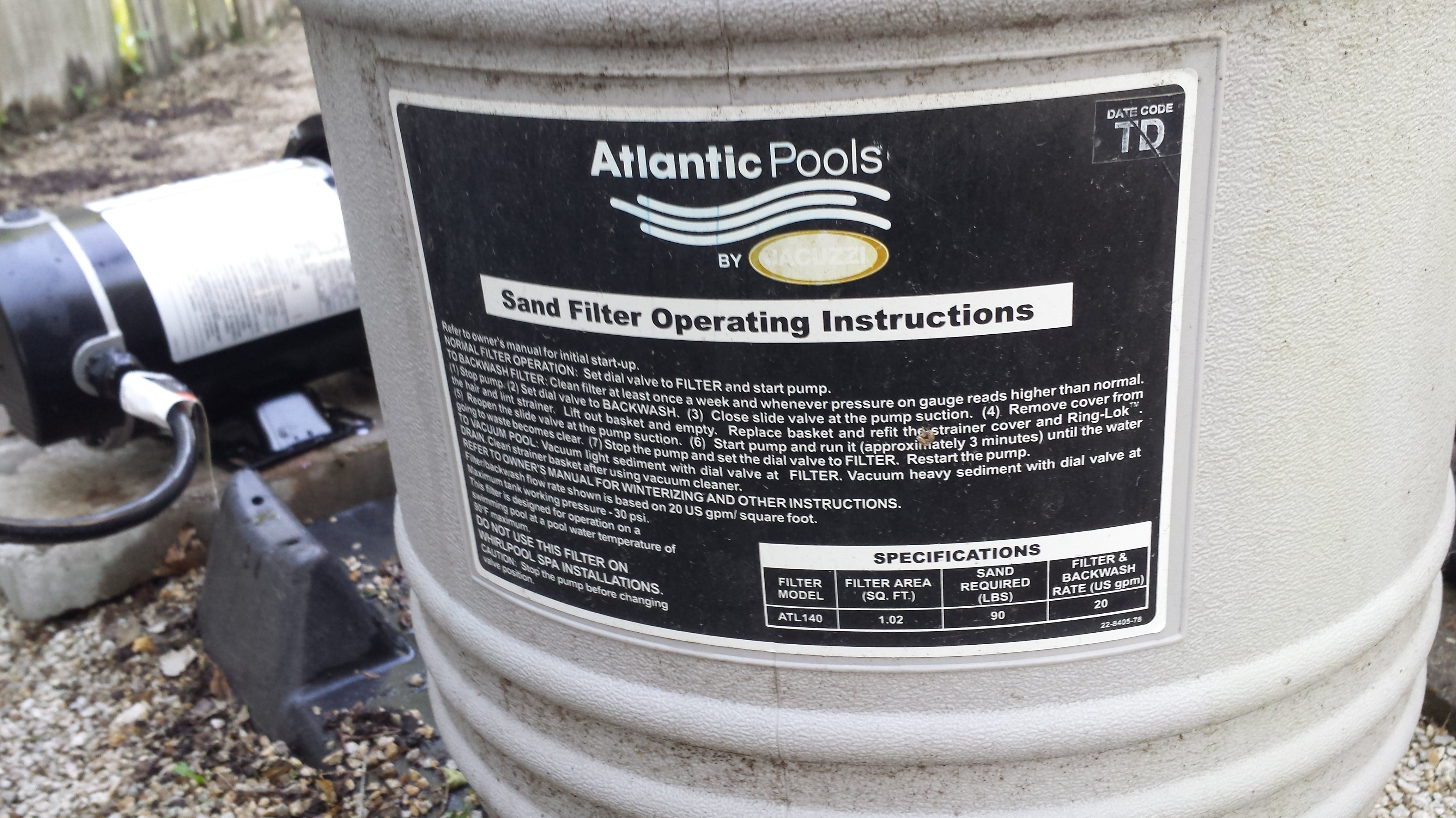

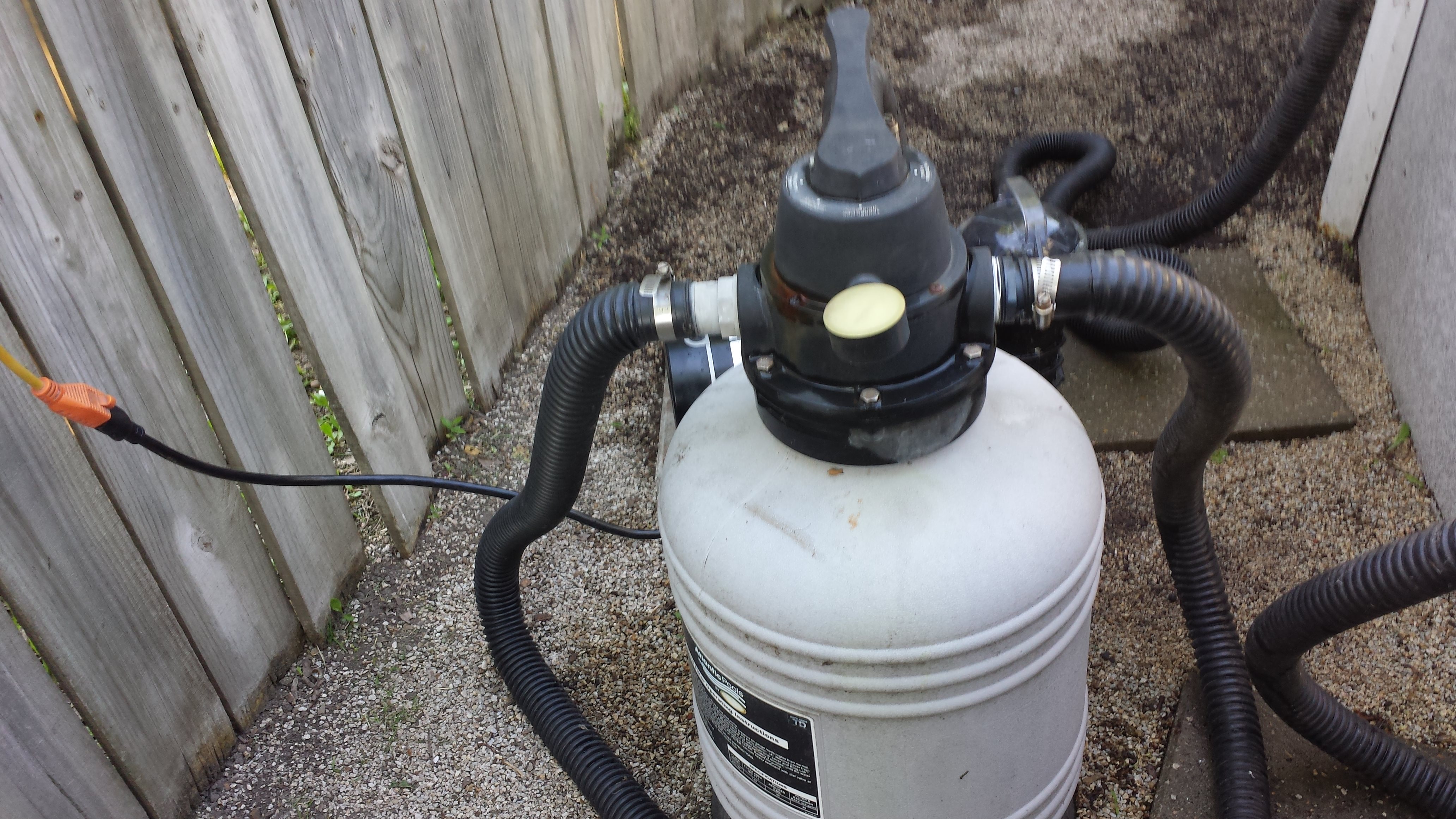

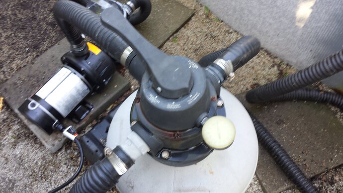

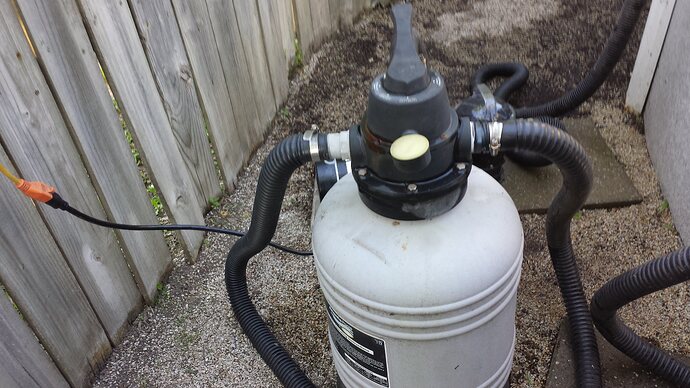

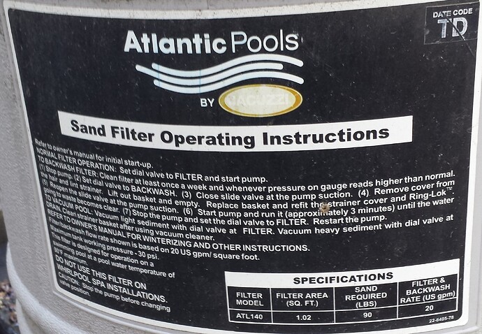

Hi Aaron,
Could you post a few photos of your filter to this thread, this would help out quite a bit. Try sending a wide shot showing the complete filter as well as a close up of the label and valve.
Here are the images that I was able to take, sorry if they are not the clearest in the world, I am not the best picture guy
Hi Aaron191,
I believe you will require this Jacuzzi 5 Postion Valve.
