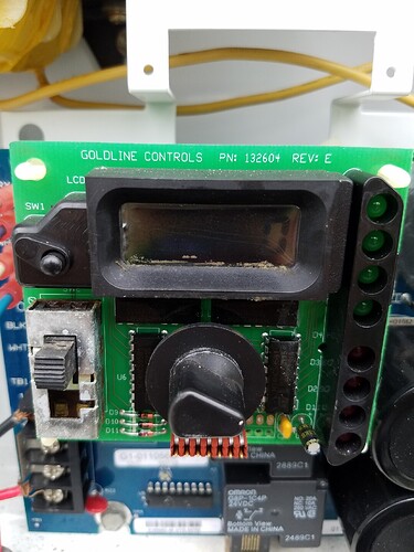

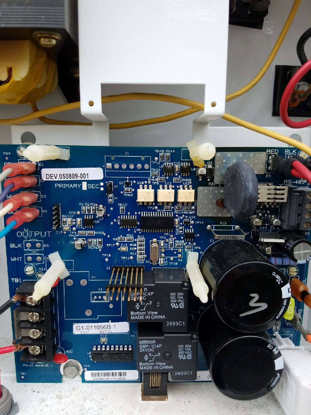

I have an Aqua Rite system and it appears that the main board and the display board may have finally given up the ghost. Cell is clean and was functioning. The fuse is good too. When it comes on the No Flow comes on for about 1 minute then goes off and nothing happens on the display or the vertical lights. I’ve been told i need to replace the main board and the display. Attached are pics i took however I am not sure what to order can you please advise.The serial number for the Aqua Rite system is 5A0210-029408. Attached are two
pics for reference. Thanks for the help.

Thanks for the photos those really help. You have two options either the Hayward OEM boards or the AfterMarket AquaRite Boards by PureLine, I personally like the aftermarket boards as we have found the quality to be the same as the Hayward Original but the price is much better. Below I have listed each of these items along with a video which may help you with your installation.
