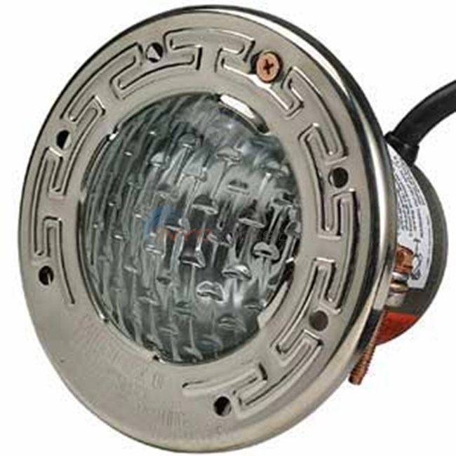

I have an old American Products in-ground pool light that I need to replace. Require a 50 foot cord.  The numbers on the light are  Series: 77XXXX  Watts 250  Volts 120  Bulb Type T-4
Use with Models 7824XX & 792066 or it may be 792006 (difficult to read)
What light fixture would I require to fit the existing light niche?

The replacement would be model 77168100. This is a 250w 120v Pentair Aqualight with a 50’ cord.
