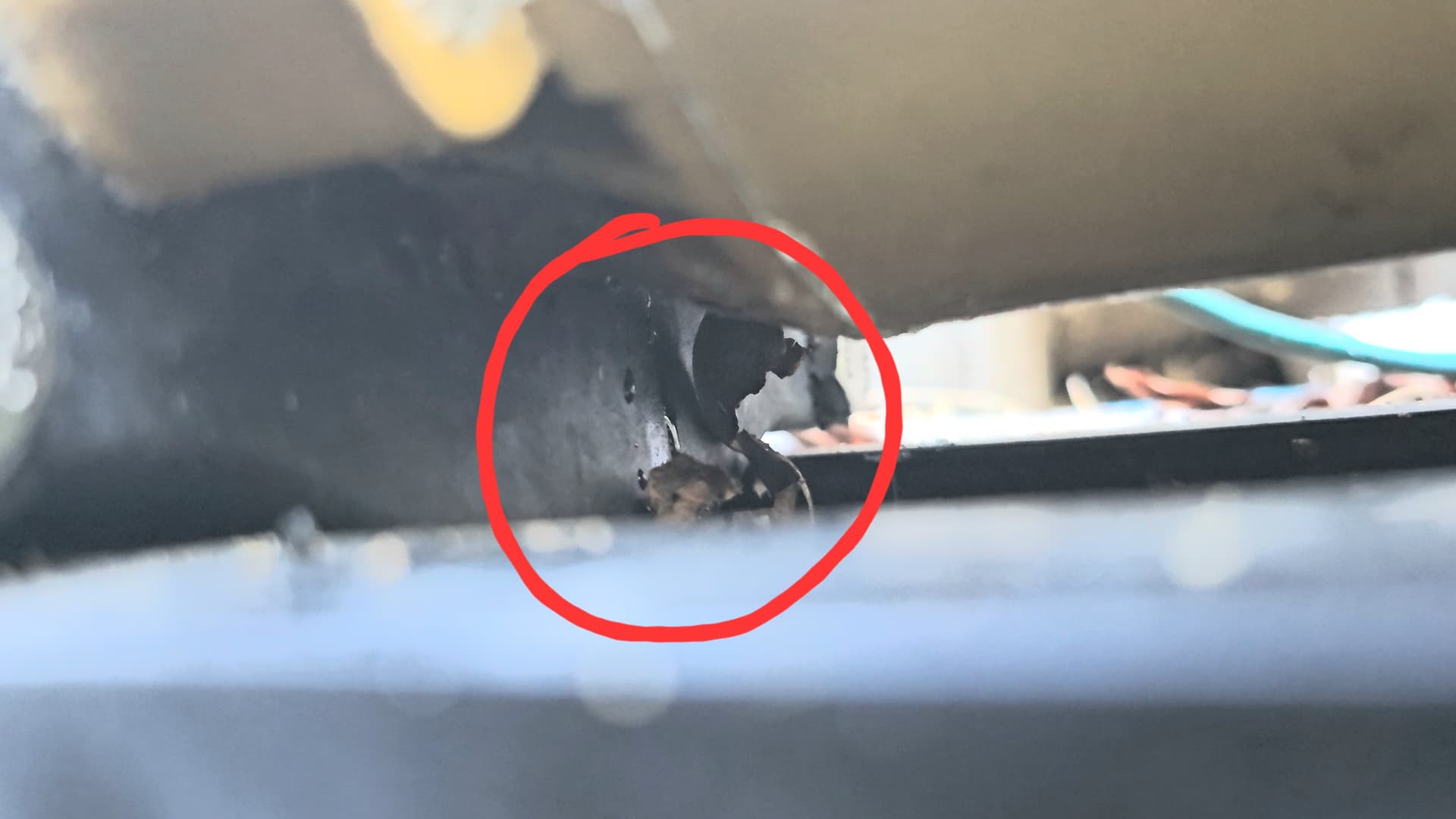

I found 2 streams of water coming from under the motor/seal. I ordered a shaft seal kit and replaced the seal. See the pictures below. Before shaft seal replacement there were 2 streams, after seal replacement there is 1 stream and still getting bubbles in return jet and cartridge filter. Again filter basket on suction side has 0 bubbles and no issues priming. The only seal I did not replace is the large O ring seal that came with the seal kit that goes between the housing and impeller/motor. Maybe that’s it?

That is probably it. Those gaskets get compressed over time and don’t seal up very well if they are reused. Get a new gasket for it and use some lubricant on it to help it seal up and stay leak-free for a long time.
Great, the only reason I reused the gasket was because the new one looked wider then the gasket that was in there. It makes sense now if they are compressed. I confirmed the kit was for my model pump. I will give that a shot after the holiday weekend and deal with the bubbles for now. Thank you for the input!
