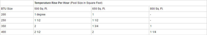

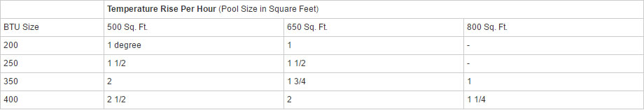

One thing you do want to consider is your gas line as the larger 406,000 BTU heater needs a larger gas line. Below is a chart to determine what size gas line you need for each BTU size.
Also if you are interested in seeing the temperature rise for various BTU sizes on your pool then you can refer to the chart below.
