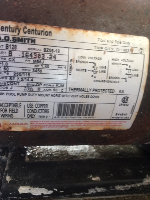

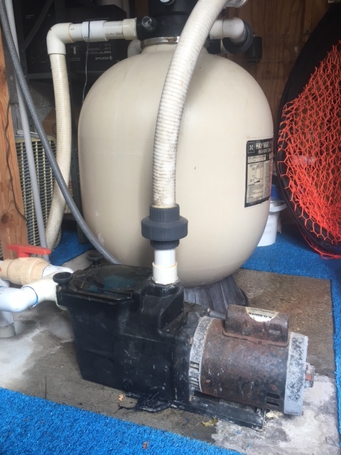

The pump keeps over heating and quits so I need to replace. It is an older pump and would like to replace with a more energy effient pump. What pump would be a replacement pump and can I switch to variable speed?
Thank you,
Donna
Thank you,
Donna
Thank you for the photos. Yes you can replace the motor with a number of different motors compatible with the Haywars Super Pump. They are as follows:
A.O. Smith 1 HP Round Flange Single Speed - UST1102
1 HP Full Rate Two Speed Motor W/ Timer - Round Flange (B975T,B2975T)
1.65 HP Variable Speed Pool Pump Motor Round Flange - ECM16CU
The Single Speed motor is the least efficient, followed by the more efficent Two Speed Motor, and the most efficent Variable Speed motor. Anytime you change out a motor, we recommend you change the seals. The correct seal kit for you is the Tune Up Kit Hayward Super Pump. You can click on the links provided to see the current pricing. Thanks for your question.
