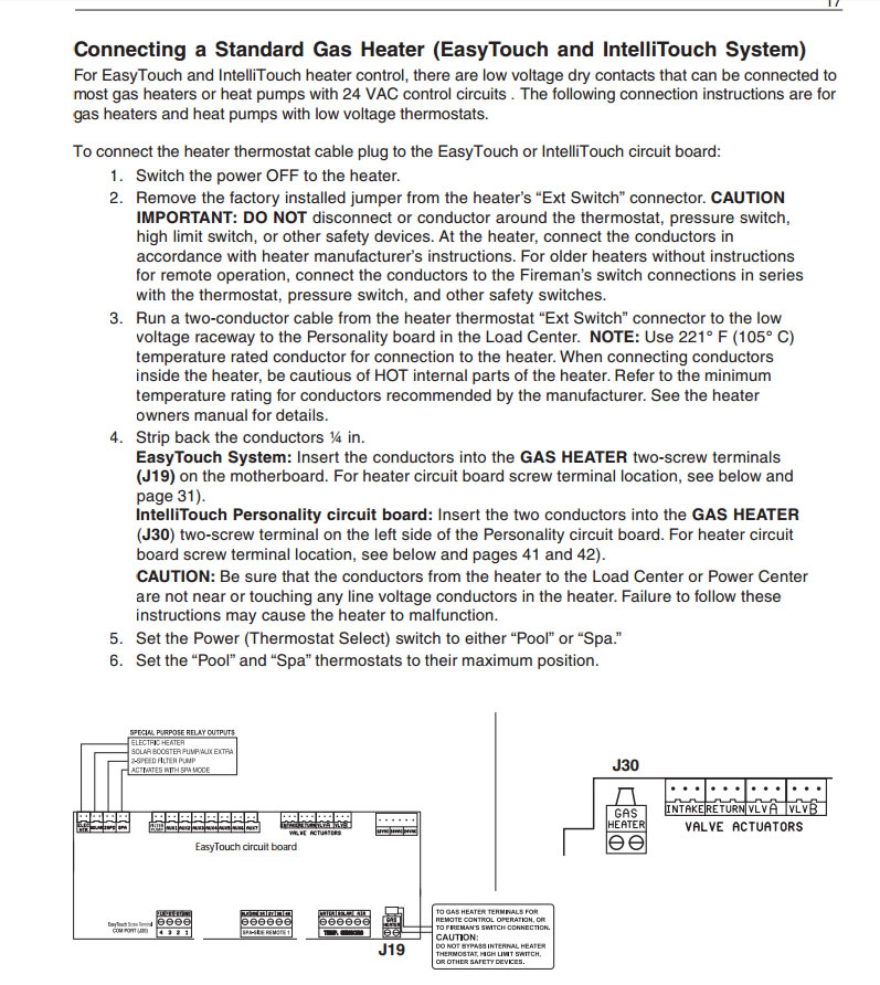

Do you know the connections from the Pentair Intellitouch to the Hayward board?

Hi Markfl,
We spoke to Pentair and they said very easy to do. They will not provide any assistance on connection to Hayward specifically, however they have general instructions on connecting to any heater, which I have listed below… If this is not the info. you need please let me know and I will research further. Thanks Patrick.
I’ll check this out. Thanks Patrick
No worries Mark, let us know how it goes.
